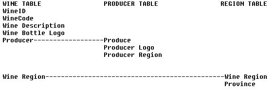

I thought the structure might look like this, but tell me if I am wrong:
WINE TABLE PRODUCER TABLE REGION TABLE

I thought the structure might look like this, but tell me if I am wrong (see attached jpg file)
I would appreciate you comments on this.

If a Producer has multiple locations, then you'd need a join table between Producers and Provinces (each province being in a region; I'm guessing). You don't really do these multiple connections with more fields in existing single-entity tables.
Then you'd just have to assign a region to the wine directly, in the wine table. You could not automatically know the region from the producer. I can't see why you'd really care what provinces and regions a producer was in; since you'd be assigning the RegionID to the wine directly. So Wines (not wineries as I had in my file, oops) would have a RegionID; simple enough.
