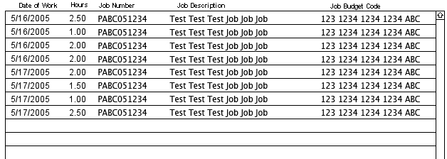

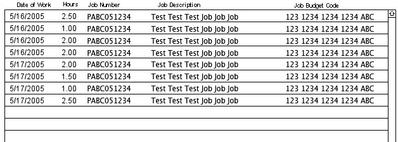

Most of this stuff is hidden or generated after the main three variables have been added. (The 3 parts of this list I'm trying to enter dynamically are marked with **asterisks**.) When I say "create new record," a new and empty (but hidden) record is created. If I try to add "with data" and use the above list, it gives me a R/W error. I don't know if I'm on the right track or even looking at the problem correctly, but there's gotta be a way.
Attached you'll find a snapshot of the database I'm working in, though I have no idea if it helps or matters at all.
I appreciate any help you can offer. InDesign scripting is my strength, so I'd certainly be happy to assist there if I ever can.
-WJW
