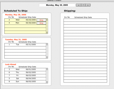

I've seen your first file, but there seemed to be too much going at once (development-wise) for me to get a grip on things.
Trying to look at it from the POV of the shipping manager, I think I would like to see the following portals:
LEFT SIDE:
1a. Backlogged Shipments (ScheduledShipDate < gToday AND not <something>);
1b. ScheduledToday Shipments (ScheduledShipDate = gToday AND not <something>);
2. ScheduledNext Shipments (ScheduledShipDate = cNextDay AND not <something>);
3. ScheduledNextNext Shipments (ScheduledShipDate = cNextNextDay AND not <something>);
RIGHT SIDE:
4. ShippingToday (PhysicalShipDay = gToday);
OPTIONALLY:
5. ShippingNext (PhysicalShipDay = cNextDay);
6. ShippingNextNext (PhysicalShipDay = cNextNextDay);
<something> would be a flag indicating that the item has been selected for physical shipping, e.g. not IsEmpty (PhysicalShipDay).
Now I would like to be able to click on a portal row to shuffle an item from Sheduled/Backlogged to Shipping (and back), so that I can organize my work visually. (Clicking on an item puts gToday into PhysicalShipDay, or clears it).
If I have the two additional portals, then perhaps I need to be asked, when I click a scheduled item, where to put it (ShipToday/ShipgNext/ShipNextNext).
gToday is a global date - I can shift it to any (working) day. When I say no more shipping today, I simply move it to the next day, and that's it.
cNextDay = gToday + 1 + Choose ( Mod ( gToday + 2 ; 7 ) ; 2 ; 1 )
cNextNextDay = gToday + 2 + Choose ( Mod ( gToday + 3 ; 7 ) ; 2 ; 1 )
If there's no shipping on Monday, then adjust accordingly. Otherwise I don't get the reason for handling Monday at all.
BTW: for good order, no one should be allowed to schedule shipping on a weekend - auto-enter calc in ScheduledShipDate should take care of that.
Is this simple enough? So why won't it work?

I see something like this (attached).
Note that the NextDay relationship is designed to catch the unlikely case of a shipment scheduled for weekend. If you're confident about that, you can simplify it to:
cNextDay = ScheduledShipDate

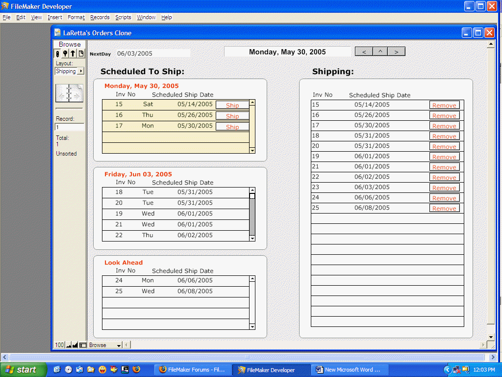

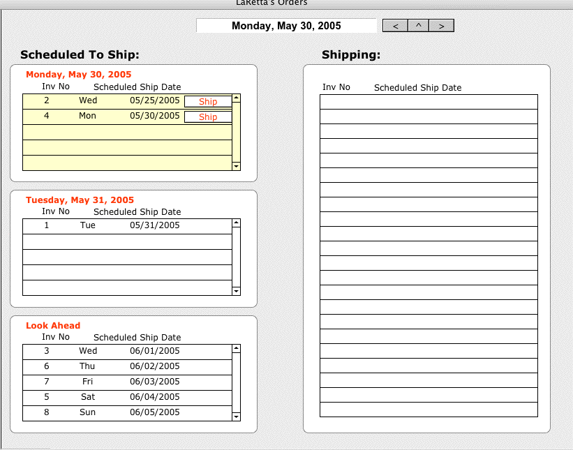

Well, we're close. But the portals still aren't shifting properly. For the test, I added a few orders scheduled prior to June and I removed the weekend entries (field validation on ScheduledShipDate won't allow weekend dates).
The Next portal should only show orders scheduled for one day. I added 5/25, 5/30 and 5/31 and changed 6/4 and 6/5 to 6/6. gToday shows Friday, June 3 and the results are correct.
But if I change the date to 5/30, the Next portal shows 5/31 through 6/3. It should only show 5/31 and Look Ahead should continue 6/1 forward. I then changed the Next relationship as you suggested. NextDay to = ScheduledShipDate and removed the gToday < ScheduledShipDate.
5/31 disappears from all portals when I enter 5/30 as gToday. I placed Shipping fields on table and gToday shows 5/30 and NextDay shows 6/3. When I change gToday to 5/31, NextDay jumps to 6/5. Thinking it might be portal refresh problem, I closed and reopened. Nada. If it's working right for you, could it them be a date conversion issue? I can attach my working copy of your demo if you wish but that's probably unnecessary.
Arrows: When gToday is 5/30 and I click the forward arrow, gToday jumps to Sunday, June 5.
We're very close! Your demo rocks! I hope you can help me figure this out. grin.gif

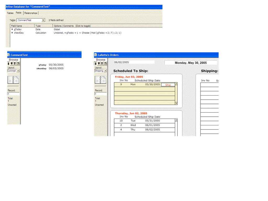

I cannot reproduce the problem. I don't quite see how this could be a date format issue, but instead of speculating, why don't you clone the file and see if it helps?

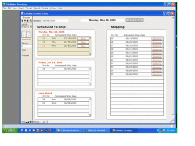

You were so fast! Well I realized I snapped a picture of the wrong file so I deleted them ALL, downloaded your file and re-created the test. The first shot - one attached here is with no changes to the relationship or calcs or anything.
It's right except it includes more records in Next than just one day. Had trouble getting a gif - we windows users aren't as spoiled with graphic abilities like you are. smile.gif
Nope. I suggest the .gif format is best for screenshots. See mine.
FWIW, I have downloaded my own attachment - still works OK.
First snap is attached above - I changed my deleted post because I couldn't attach two pics to one post.

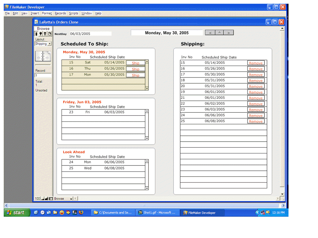

Okay, here's the one where I try to restrict the second portal to only show the next day.
All I changed is relationship NextDay = ScheduledShip and removed the gToday line.
So your demo works except more than one day appearing in Next (in first pic) and disappearing in second pic. And if I attempt to restrict Next to one day, it breaks because cNextDay shows 6/3. The NextDay calc jumps ahead more than one day (see field on top of pics to left of gToday) - even when gToday is a weekday such as Monday. wink.gif
I don't know - something is very wrong here. The only thing I can suggest is download my file again, clone it and before making any changes (other than changing the scheduled ship dates in the Invoices table) see if it misbehaves.
I did that three times and the first gif (attached above) is the result - after clone with no records and NO changes to it. I just deleted everything and tried again. cNextDay displays 6/3 when gToday is 5/30.

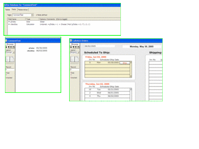

Well, I'm posting back. I doubt anyone but Michael has hung in there. But just in case, I'd like to explain my findings:
I've attached another screen shot. I re-created Michael's calc in a brand new file (displayed left side define fields then resultant brand new layout FM created). As you will see, it displays 6/3 when 5/30 is entered. Wrong.
THEN ... I changed the demo file. I created a new global called gNewToday (global date). And I repointed NextDay calc and all relationships to it instead. In the view to the right is that same file I posted earlier. I respecified gToday May 30, 2005 field to new global gToday. Please look to the left and see the NextDay calc.
I just created this same calc in vs. 6. It displays 5/31 as it should have. It must be my system. For the life of me, it shouldn't matter but I'm not insane. I was beginning to wonder. I'm using XP Home Edition.
Hey!!!! This might actually be good news!!!! Maybe this is why sometimes my date calculations produce results I think they shouldn't!!! Could this be it and not just that I don't understand the date logic? No wonder these calcs weren't making sense ... I understood their logic but when working with them, they never produced logical results and so I doubt myself and my thinking constantly!!
Okay, okay ... I can't use that for ALL my inabilities to solve many calculations ... but it certainly explans this one! I understood NextDay calc but, when it produced 6/3, I assumed I misunderstood everything I thought I was learning!! I just don't assume computers can make mistakes. But they can. And my screen shots show it.
WHEW! My problem isn't solved but my sanity is still intact (pretty-much)! grin.gif

Okay, thanks to Michael, we broke the calc down into two calcs and created a third for the joins. It works!!!
gToday = 6/3/2005
calc 1: gToday + 1
result: 6/4/2005
calc 2: Choose ( Mod ( gToday + 2 ; 7 ) ; 2 ; 1 )
result: 2
calc 3:
calc 1 + cal 2
result: 6/6/2005
But a combined calc of:
result: 6/8/2005 (WRONG)
Just in case anyone is interested. It is probably an isolated problem with XP Home Edition with 7.0v1. But at least I can finish this project tonight and I'm moving upgrading to 7.0v3 to the top of my tight priority list!
