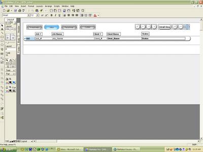

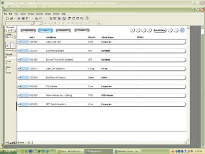

I have a template that I have been using and have been making some modifications to it to fit my needs..I have adjusted the fields in a portal, but now when I browse the records in list view all the lines are double spaced, and I want to get them back to being single spaced.
Attached is a screen shot.

From the Screen Shot, it appears that in your adjustments, you move the bottom of your Body Part. This often happens when you add a field to a List View.

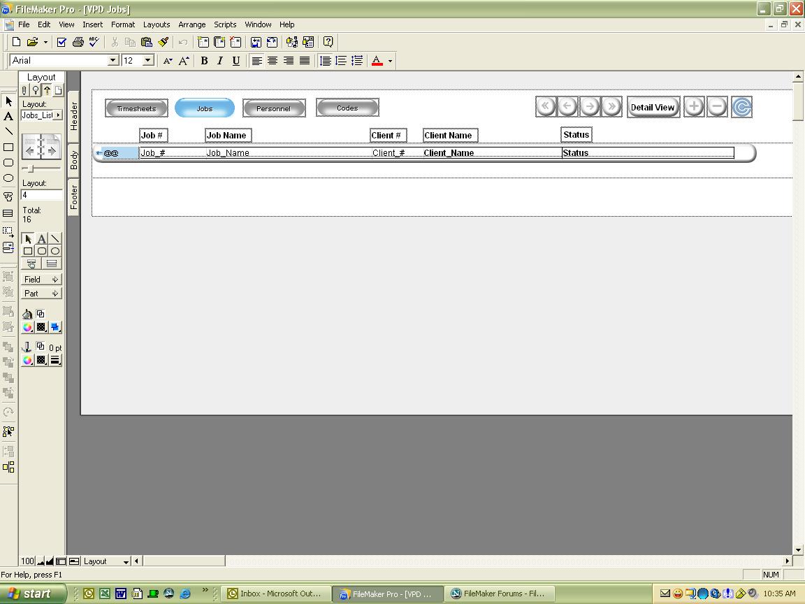

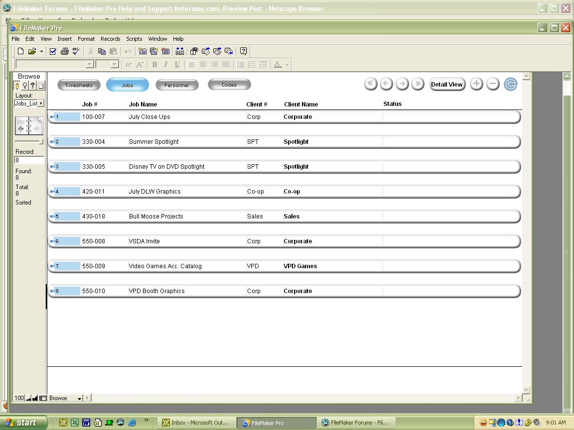

Well I just checked in layout mode and it all looks right to me...one more screen shot...
forgot the attachment
Move the bottom of your body part up against the bottom of the list. That 1/2 inch or so of space will appear on each record otherwise.

What JT said was the what I was trying to say.
Your 2nd screen shot just confirmed ti.
Thank you all...that fixed it right up!!!
