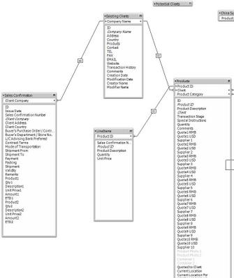

Let me post my relationship diagram, perhaps it will clarify my clumsy description?
Posting your relationship graph will always help us. But I'm unsure how best to provide the conditional products you require. There is nothing wrong with your needs nor your description of them.
I believe you will need another relationship from LineItems to Products (filtered through Clients) and I've just never done that before. So I would hate to make suggestions on something I've never used myself in a business environment. There are many great Developers on this Forum who possess direct experience on it. They can provide more qualified assistance.
I'll give my two-cents if I think I have something worthwhile to contribute though. smile.gif
Update: Even full screen, I can't read the text ... my eyes aren't so great. Maybe others can read it - or can you make it bigger?
LaRetta

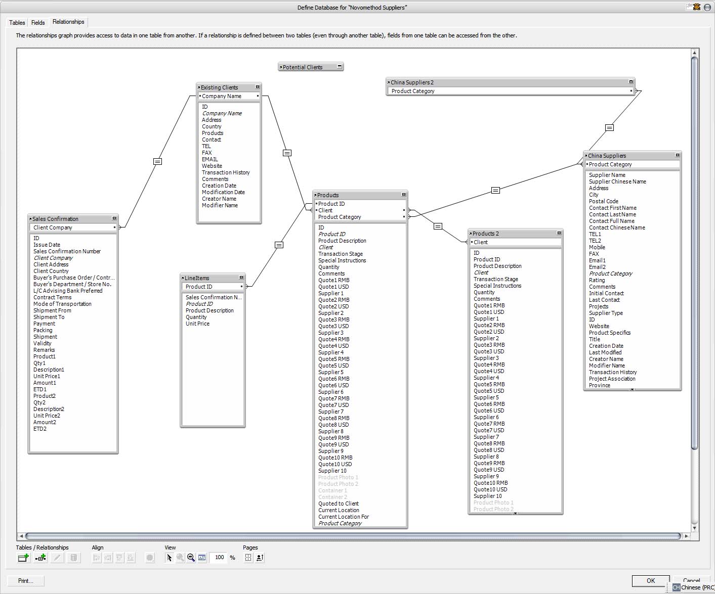

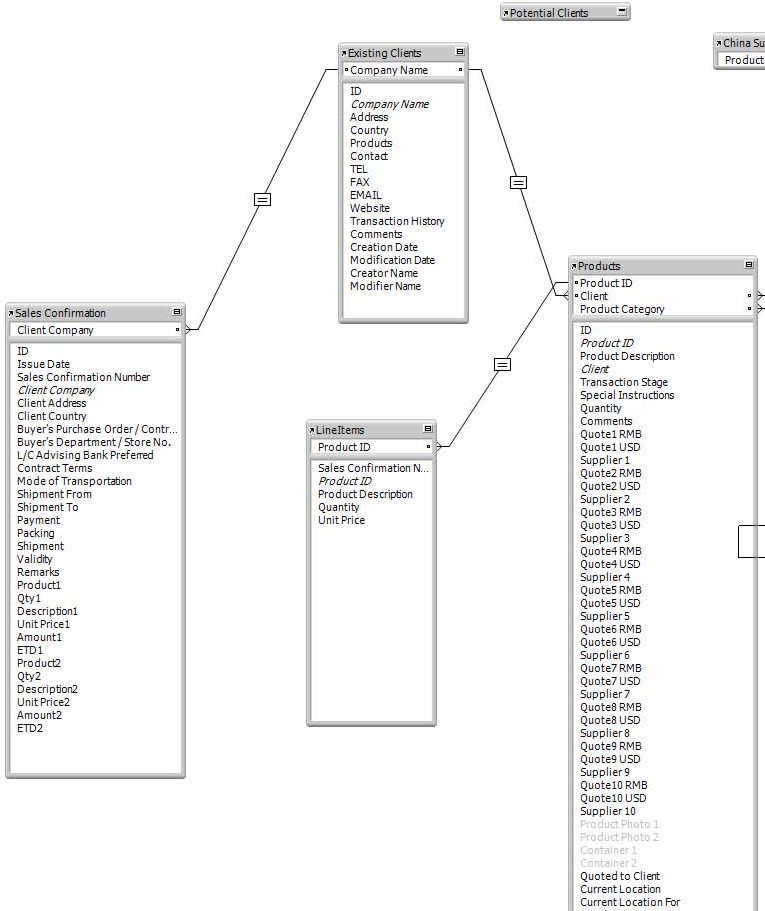

Thanks LaRetta. Here's it is enlarged abit if you are still interested!
Comment's file looks good to me. The InvoiceLineItem is also the join table in aa many to many relationship between Invoice and Product. In Product you could add a portal to show the invoices in which the product was used.
As it is setup now only one customer can buy a product. Is this what you want?
Thanks Comment, that is a clever solution and works nicely!
Ralph: Well, one customer per invoice.
