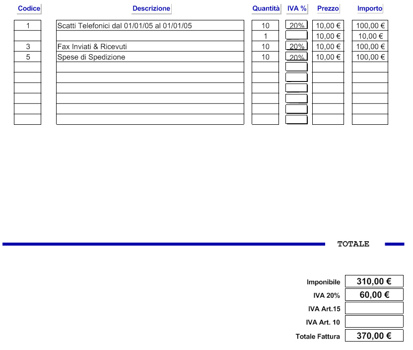

I actually don't need to make d"ivision by 0", I need to make "multiply by 0" (in case tax (IVA) is not present (Art.15 & Art.4)), my problem mostly is that for each line (Item Description, quantity, price, tax) I gotta calculate if there are taxes and if not how much is non taxable and at the end of the invoice I gotta present 5 totals: Total price (without taxes) Grandtotal (taxes + total prices), Total of IVA20%, Total of notax Art.15, Total of notax Art.4 (As from the screenshot I attached)

@Soren: Ok, I think I simplified a bit the problem but it's still there.
I got rid of the subtotal "Art.15" and "Art.4" since I realized that by the current law I'm allowed; I still got the problem with the popup menu and the attached value list, since if I choose "20%" I should get a multiplier by 20, if I choose "Art.15" or "Art.4" Multiplier should be zero and it shouldn't interfere with the Grand Total and with the "Total IVA20%", so I'm attaching the whole database here hoping it's just a problem of syntax and it's easily solvable :
