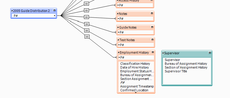

I'd like the supervisor field in our main layout/table ("2005 Guide Distribution 2" table) to show the supervisor of an employee based upon the employee's section which is listed in a seperate table ("Employment History" table).
Supervisor information (section and supervisor name) is located in a seperate table as well ("Supervisor" table).
I've attached an image showing current relationships and tables. Any code, calculations, relationship advice, etc. would be very helpful. This is the last part of the database and I just can't get it figured out!

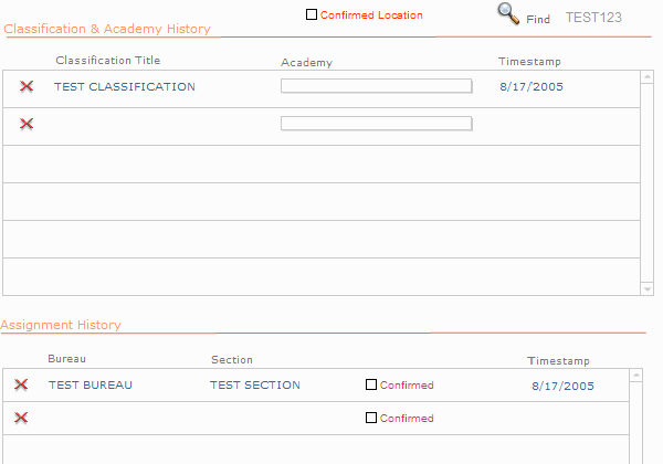

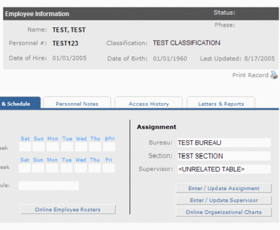

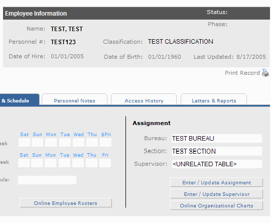

I'm attaching what the main layout looks like that shows the bureau & section (this is in the main layout 'guide' and uses calculations that shows the last posted section/bureau from the 'assignment' table).
It *looks* like in the database you posted (looked really good!) that you have to specify the supervisor to the employee? Maybe I'm wrong. I just need it to populate the field with the supervisor based on the section for the employee in the 'assignment' table.
For example in the first image the bureau and section are a calculation
last(employment history::section)
that shows the last bureau and section the employee is in from the 'assignment' table. I'm wondering if there is a way to do this with the supervisor...the only difference is we have one record we will update based on the section (the section is the main records in the 'supervisor' table). So if it says "research" section it will look for 'research' section in the 'supervisor' table and return the name of the supervisor in that record.
