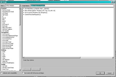

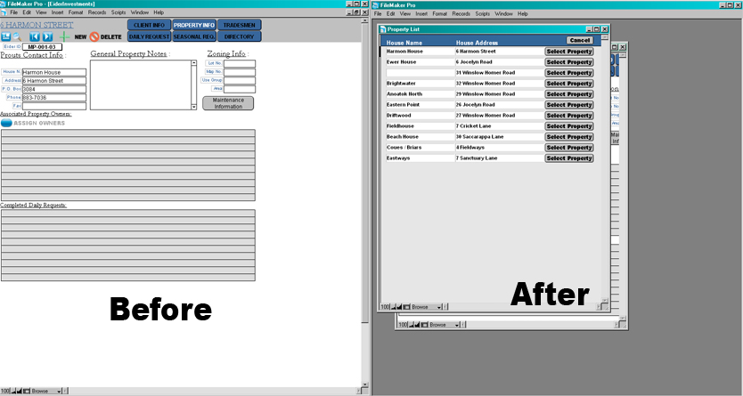

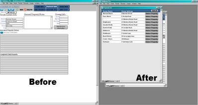

When I click the button to run my new window script it opens a new window but then resizes my main window?
Can anyone tell me why this is happening?

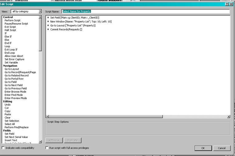

I suppose you might be able to add a few script steps to fix this, but I don't know if it will work. You can try:
Adjust Window (Size to fit) on your main window, then do a select window on the one in front. That might work.
This is the best fix I've found so far when you want the main window to remain semi-maximized.
Freeze Window
Adjust Window [Maximize]
Move/Resize Window [Current Window; Height: Get(WindowHeight); Width: Get(WindowWidth); Top: 0; Left: 0]
New Window [{your parameters}]
If you have a script close the new window, then it can maximize the main window again.
