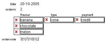

I have attached an example of how you could do this. You should take into account that you want for instance more than one icecream flavours per order and that you can easily add new payment methods or packing material without having to redefine your calc. every single time. If not it´s ok, but with databasing it´s just like marriage...be prepared for the worst :
So In the example I already did that for you. Hopefully you can adjust it to your system. Good luck.

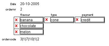

That is exactly what I meant with my examplefile:
ordercode explained:
3= 3 flavours
1= chocolate
7= banana
10= melon
1= cone
2= credit
valuecode.zip
