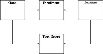

In general, when tables contain similarly structured data, they should be combined. If the data in each of your grades's tables is pretty similar, then those tables should be combined. You can add fields to distinguish between the grades.
What I'd recommend for the typical Student-Enrollment system is a table for the Student info, a table for the Enrollment info, a table for the Class info, and a table for the Test Scores. This way a Student can have more than one Enrollment record (one for each year,) and they can also have multiple tests. The Test Score record might just be a final score (with the Exam Date,) or you might include have a series of test questions in there that get recorded each time.
The final structure depends on what the needs are for your specific situation, but you want to try to "normalize" the structure as much as possible. More about normalization can be found on the web or in database design books.

No, the fields in the Test Score table would be more like this:
StudentID (number)
ClassID (number)
Season (text)
Test Type (text)
Score (number)
Exam Date (date)
There is a one-to-many relationship between Student and Test Score, so each Student has multiple related Test Score records, one for each Season, Test Type, Date. The Student <=> Test Score relationship is based on StudentID, the Class <=> Test Score relationship is based on ClassID. These Test Scores could be entered through a portal either from a layout based on the Student table or a layout based on the Class table. You may also need an Enrollment <=> Test Scores relationship, to pull the last ClassID over into newly created Test Score records.
