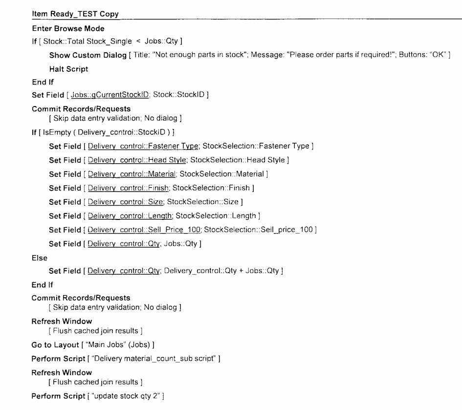

I have posted the script as a scan. I hope this helps. Basically, I have almost got it working, all steps work apart from the last op (perform script ["update stock qty 2"] This script does not function at all. The script itself works, but only if its assigned to a button on its own.

That last script should work fine ... except ...
Scripts fire depending upon the layout they are on at the time. In that last script, do you have a layout switch to the proper table occurrence? If it fires from a button, it must be on the same table occurrence as the one the button is on. Otherwise, it's firing on the wrong TO and won't work.
Also, do you have a script parameter attached to that button?

Yep. Can you post that last sub-script for us? Because, how can a script (fired based upon the existing layout) know which row (related record) it's supposed to work on?

Okay, that last sub-script "Update Stock Quantity" ... on a related record? That's your problem.
Which related record should it be setting? It's probably setting the first one ...

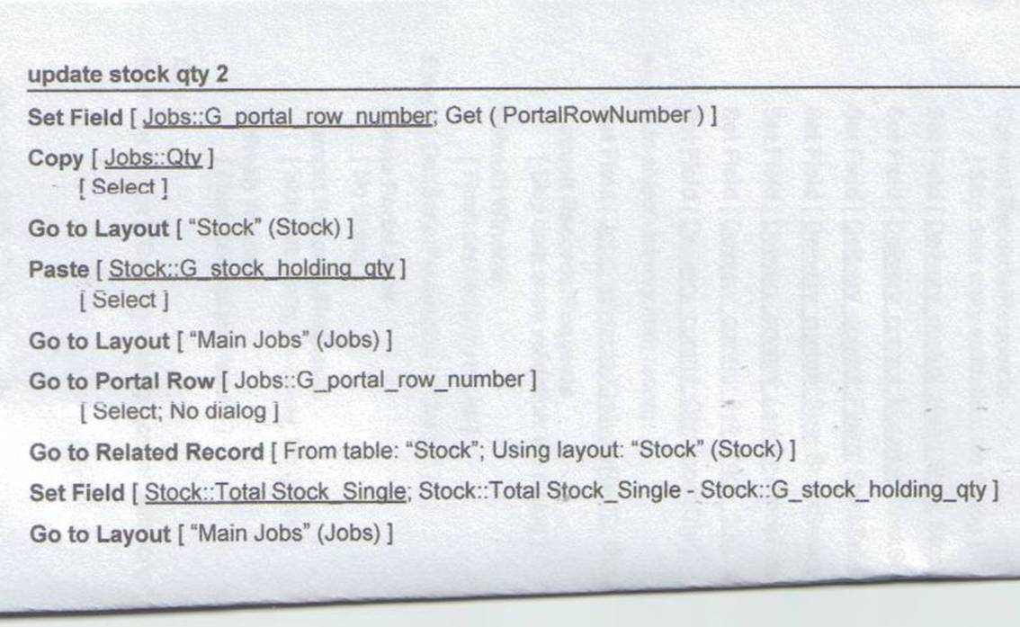

Yes, of course. I have posted the script for you too see. I te does include a related record function. Probably does'nt help either??

As you can see, that first Set Field [] can't act. It doesn't know the portal row number because you're not in a portal when you set your global. That script parameter which you thought was redundant ... isn't. :wink2:
UPDATE after your update ... well no - just including the sub-script in the main won't help. The problem is isolating the specific related record you want to work on. But I don't understand your process here. Why do you need the portal number at all? I think there are much easier ways to accomplish what you're trying to do. Can you post a sample file? I see no need to jump around like you're doing. And I wouldn't use copy/paste either...

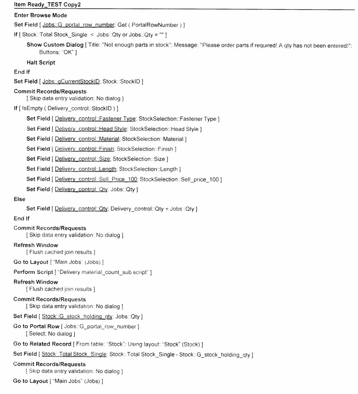

Hi LaRetta, I have since been trawling through ideas, trying to apply some of your theory. I have made it work, however. I am not so sure it is the easiest way. I have incorporated it all into one script. I have also removed the need for copy and pasting. Yes, not good for this application, or any infact.
Please view the script attached. If there is an easier way then I would love to know what it is. The flavour i've been chewing does'nt taste so good after 5 hours or so. If you know what I mean.
Thanks for your advice. It has helped tremendously. Still to be improved I am sure.
