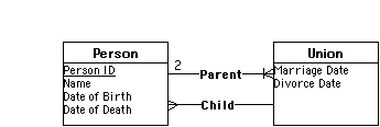

I'm thinking a structure similar to that shown in the attached ER Diagram (note that an ER Diagram is not exactly the same as the TOG (Table Occurence Graph) used to actually build the relationships in FileMaker.)
A Person could be a parent in one or more Unions. A Union has 2 parents and zero or more children. A child is a member of one Union.
The trouble you may run into when attempting this geneology model in FileMaker, is actually getting the data to display multiple generations. It's easy to show a spouse and children, but to show multiple generations all at once requires multiple copies of the table occurences, all linked in a big chain.
I attempted to do this same thing a few years ago, and quickly found out that I was going way too deep to create a good program that I would be satisfied with. I'm sure using FM 8 would make things a bit easier nowadays.
Thinking it through a bit, you'll want to have several join tables to relate a person to another person through various means, like marriage, children, etc... One join table for each kind of relationship. This will make it easier to display the related info on an individual basis.
