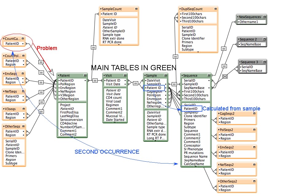

having a little trouble with a counting function in a database with several related tables. The database consists of 4 tables related in a linear fashion from patients to visits to samples to sequences. Each relationship from left to right is one-to-many. Sequences is related to samples via sample ID which is defined in both tables. Sequences also has a calculated field "PatientID", which is a manually entered value (stored) in samples, and a calculated field (patientID = samples::patientID) in sequences.
I am hoping to be able to go to a record in patients, and count how many sequences from a particular region (for example, the "gag" region) from that patient are present in the table sequences.
At the moment, I have a global variable "gag" in patients, and created a second occurrence of the table sequences called "gagsequences" that is related to patients via patient ID and region. I then just defined numberofgagsequeces in patients as count(gagsequences::anyfield). Unfortunately, the table patients does not seem to "see" the value patient ID in the gagsequences occurrence, and therefore the result is always 0.
I played around, and if I turned the field "patientID" in sequences into a simple number entry (no longer a calculation), the relationship worked, so that seems to be the problem. However, in its original configuration with patientId calculated, a search in sequences will find these values as if they were stored. Only the relationship with the table patients doesn't see the values. Is there any other way to configure this?
Relationship photo attached. Any thoughts greatly appreciated!
marcel

Thanks David. Unfortunately, this counts ALL sequences from a given patient in the related table sequences, instead of the subset of sequences from that patient that have "gag" in the region field. This was why I thought I needed another occurrence of sequences with a join to both region and patient ID, but I can't get the relationship to work.
Marcel
For a relationship to work, the matchfield in the related (child) table must be indexable. Unstored calculations are searchable (though slow), but not indexable.
Either make PatientID in Sequences a lookup/auto-enter, or put the global filter field in the Samples table, and define another relationship:
Samples::SampleID = Sequences2::SampleID
AND
Samples::gRegion = Sequences2::Region
This will enable you to count, from Patient, the sequences that have the region entered in the global gRegion field.
Global fields are accessible from anywhere, so you can put the global filter on Patient's layout, for example, and control it from there.

Making patientID a lookup would work, but the field only seems to update when I enter a new sequence
That's what relookup is for.
I get the total number of gag sequences in the table sequences, and not just those gag sequences from the particular patient
Mhmm.. I don't know why. See the attached demo for how it can work.
Note that my tables are connected in a cascade, always using the parent table SerialID as the matchfield. These fields are auto entered, and should NEVER be edited by the users. In fact, users don't even need to see them or know about them at all.
This is much simpler than trying to get the PatientID from high above, and use it as a match for the level below. And it allows you to put any parent field on the child/grandchild/etc. layout - so on a sequence layout you can have fields telling you any detail of the parent sample/visit/patient, without storing redundant information.

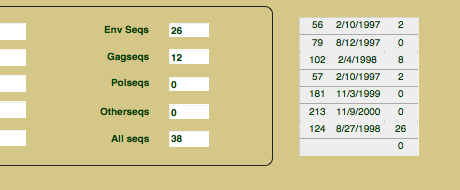

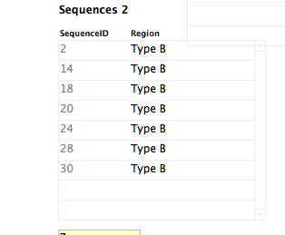

I tried to insert a portal in "patients" as you have in your example. In my case, I hoped to show all of the samples for a given patient, and the number of sequences from each sample next to it. I was able to do this but found the behavior of portals to be a bit strange, both in terms layout and formatting.
In terms of layout, when I insert the portal and go through the dialog boxes to insert the desired fields, I get a portal grid, where the entries would be, and I also get two free-floating fields just as I would if I inserted a new field in the layout. For a long time, I couldn't get the portal to show my data, until I put the two fields on top of the top row of the portal, after which the portal grid showed the data correctly in browse mode. Is this the way portals are supposed to behave?
Also, my portals look a little rough and amateurish with a lot of background lines, etc... whereas the ones in your example look very neat with left-justified. Unfortunately, I found that it was difficult manipulate portal formats. I looked at the FM help section on portals, but didn't find it to be of much help. Are there any tricks that I should be aware of?
I have never seen anything like this. The only thing that comes to mind is make sure you're patched up to version 7.0v3.
There's not much to format in a portal. The text justification is done on field level.
The first png above can happen this way:
File created in 7.0v1. File then modified in 7.0v3. File then again opened in 7.0v1. The version upgrade changed rendering (you will also notice vast font-rendering differences). I have the same issue when I open a 7.0v3 file on a 7.0v1 machine. Portals disappear - half my buttons disappear. In fact, if the screen resolution on the 7.0v1 machine is set to greater than 1024x768, the text disappears completely - not just the portals and buttons. This is on Windows ... I don't know whether it causes font display problems on Macs at all. But I would bet, as Michael indicated, that it's a version thing ...
When it first happened to me, I thought I was going blind! :wink2:
