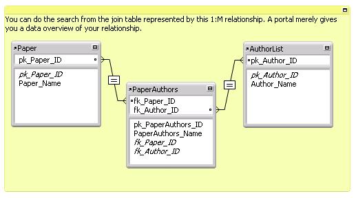

Your post title is kind of misleading. From what I can tell, you are asking from which table can you do your search effectively! I think your join table would be the ideal place to do the search in a 1:M relationship.
You can do that in a portal in the Paper table. Note: The pk_Paper_ID and pk_Author_ID are unique, such as, auto-enter serial ID fields. See attached quick sample.

I appreciate your help and your sample makes perfect sense. But, when I try to duplicate it I have problems. I have attached my version.
portals.fp7.zip
change the result of your calculation for calculated NAME in the STAFF TABLE from NUMBER to TEXT.
