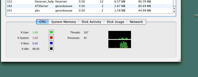

January 23, 200620 yr I examined the CPU activity when FMSA7 was running as of recent and detected that both processors are not engaged on my dual 2.0 gHz G5. No matter what the query is, only one processor shows any activity in the Apple Activity Monitor. I think FM has lied about the server capable of being dual processor.

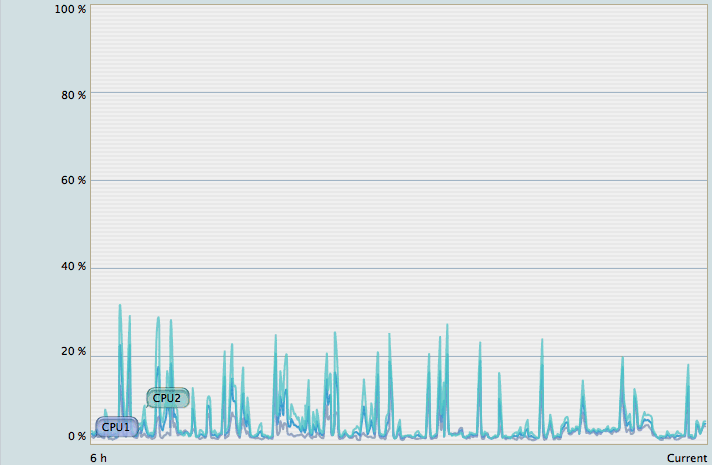

January 23, 200620 yr To clarify: The dual-CPU problems only occur with the web publishing part of FMS7A, see http://filemaker.custhelp.com/cgi-bin/filemaker.cfg/php/enduser/std_adp.php?p_faqid=5303 Indeed we had to turn one CPU on our WPE/web server off, however on our FMS7 DB server still both CPUs run. It is not completely clear if FMS7 takes advantage of this, see the CPU usage graph for the last 6 hours; the curves are a little bit different which shows that the load is distributed +/- to both CPUs. However, a second CPU may help if also other applications would run on the server; this, however, is not recommended practice, e.g. a FM server should be dedicated only to FMS. I had already made some tests with FMS8A on a test dual-CPU machine; the CWP pages that made problems on a dual FMS7A dual-CPU server don't do anymore.
January 24, 200620 yr Author Here is FMSA7 (no web companion) handling a query that searched through 4 million records. Note that one CPU is handling all the work.

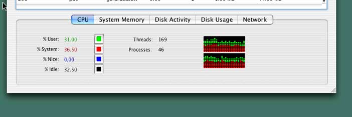

January 24, 200620 yr Author Okay - On a second search using 2 separate clients I got this. Eureeka. Both CPU's came alive. THEN WHY DOES FM say this has been corrected in version 8 of FMPSA?? I have been testing it using a single client. Single client does not invoke multi-threading apparently. Picture_5.pdf Edited January 24, 200620 yr by Guest
January 24, 200620 yr There's really no good way to use multiple processors for a single request. What FMI is talking about is the bug in the WPE with dual-processor systems - that is what has been fixed with FMSA8. - John
January 25, 200620 yr From a programmer's point of view, searches are pretty bad to parallelize or to split into multiple threads. The database search algorithm has to walk through a decision tree of hashed index terms. Each decision depends on the previous decision and therefore the steps must be processed in serial order. Sorts are much better, because they can be split into chunks.
