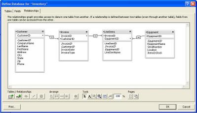

I'm a newbie working on an equipment rental project, and I'm having some trouble with my relationships (aren't we all?). I've seen a few similar posts, using three tables, but the solution I'm working with has four tables, as follows:
Customer (primary key = CustomerID)
Invoice (primary key = InvoiceID)
LineItems (primary key = LineItemID)
Equipment (primary key = EquipmentID)

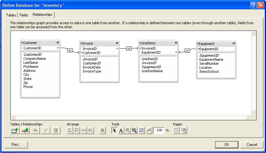

The attached image file shows the current setup of my tables.
I'm confused about how to add Equipment data to the invoices, and I basically have two problems (that I know of, anyway)...
First, I'd like users to enter an equipment name in a portal on the Invoice layout and then have a popup within that LineItem that shows them a list of available SerialNumbers from which to chose. With the LineItems table linked to the Equipment table via the EquipmentID, I'm not sure how to get the LineItems layout to see the available SerialNumbers without an EquipmentID being assigned. I can get the mechanics of the portal and popup working by using a LineItemName field to set the name of the equipment and then run a script that finds all the available SerialNumbers in the Equipment table whose EquipmentName matches the LineItemName. The only problem is that the LineItems table can't see the results of the search in the Equipment table because no EquipmentID is assigned until after the user selects one.
The second problem is that the people for whom I'm creating the database want to enter their own serial numbers; that's why my Equipment table has two "serial number"-type fields -- EquipmentID and SerialNumber. Everything I've read so far about primary keys has said to always use an auto-generated key to make sure the key stays unique, but I'm not sure how to properly relate their manually entered SerialNumber to my EquipmentID. By the way, I do validate the SerialNumber they enter to make sure it's unique.
Am I even remotely on track with my table relationships? Can anyone provide any suggestions or insight?
This is my first post ever, so if my questions aren't clear, or I've somehow managed to offend anyone and/or everyone, please go easy on me.
Thank you all in advance for any help you can provide!
Chrisbee

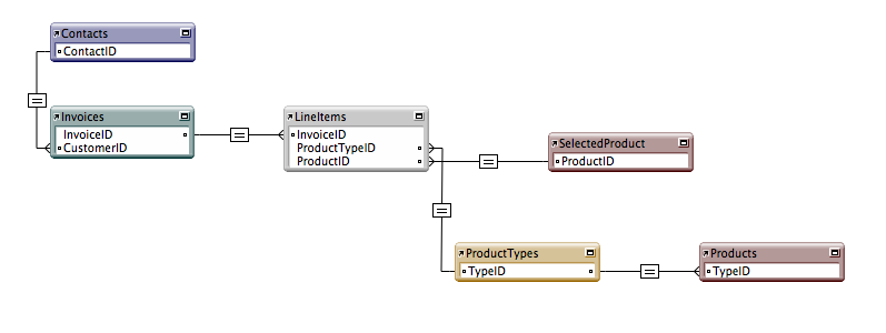

Try along the lines of the attached?
Hi comment,
Thanks for responding! I mostly understand what you mean but want to clarify.
Would TypeID be a unique, auto-generated ID or the category of equipment? If it's auto-generated, I'm not sure how to use it in the LineItems table because the user wouldn't know the TypeID values. If, on the other hand, TypeID is an actual type of equipment (by name), that would work from the user's standpoint.
I'm also still not sure how the LineItems table would see the ProductID if the user hasn't picked a specific item yet. What am I missing?
Thanks again for your help!
Chrisbee
It's all about value lists, for both questions. I'll address your second question first:
First, the user selects a category (ProductTypeID). He/she does so from a value list listing ALL values in the field ProductTypes::ProductTypeID. Once a choice has been made, a relationship is established between LineItems and ProductTypes (and by extension, also between LineItems and Products).
Now we need another value list to pick the actual product. This will be a value list of values from field Products::ProductID, showing only related values starting from LineItems. Once this choice has been made, a relationship is established between LineItems and SelectedProduct.
Regarding your first question, I prefer auto-generated serial IDs for relationships. Just think of someone deciding to rename a category, or even just discovering a typo.
A value list can be defined to show a value from a second field, so the user knows what he/she is choosing. In version 8, you can choose to hide the serial ID completely from the user (there are methods to achieve the same effect in previous versions, but that is a user-interface issue).
