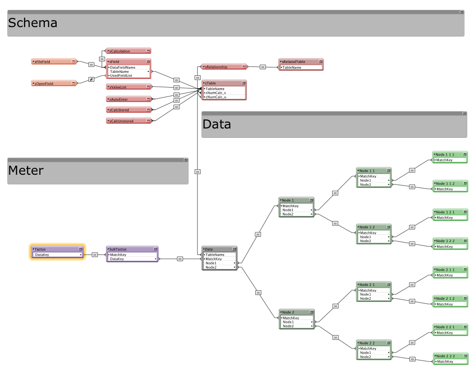

Razumovsky Posted July 13, 2006 Author Posted July 13, 2006 Allow me to post this question. Is not this single table idea nothing more than a really large "Multipurpose Table"? Exactly, it is not complicated or fancy at all in that maner. But the model conceives of it more as a single-purpose table: for the purpose of holding data. We are normalizing our workflow as developers here. Having multiple tables for data is relationally akin to encountering a client that has an in-house designed DB with "Apples', 'Oranges,' and 'Pears' as separate tables in their structure. I almost gave up on this - found that in a certain way I was spending a lot of time building FM3 using FM 8. I put it aside for a spell, but returned to it recently because I realized I had been working on a nearly identical problem in music/perception theory for the past year or so, and was making the same normalization errors there. I have a solid working draft together (several steps up the evolutionary ladder from the Singles Table at the Champagne Room), but I can tell that the initial legwork for a practical version will be time consuming, and the file is already becoming a bit proprietary in nature. I have made progress on a lot of the readability issues though (and there are a lot of them - the relational recursion helps tremendously with this however), and will strip down the file to a cleaner proof-of-concept next week when I get back from vacation (it is very sticky in Brooklyn about this time). I trust I will get some good feedback on what it is lacking and how to improve on it. Plus, I hope some of you might actually get a kick out of it. I attached a little preview for now. This is derived from a Customer-Invoice-Item-Product relational state.
Razumovsky Posted July 13, 2006 Author Posted July 13, 2006 Yes, it is a converted solution, and I've gotten rid of 100's and 100's of scripts. However, even if I wrote it from scratch, and it had 1000-1500 scripts, I can't see having them all in 1 file. This is an interesting point that I had not considered. You could have a single table with multiple empty files for your scripts, but I have not really thought through those details. It does seem like an excessive number of scripts, but regardless, it would be great to have a better way of organizing scripts in general. I think the new object functions will help a lot in normalizing scripting work as well (I think I may add a Script table). If only there was an evaluate script step. Then you could have a field with text: Set Field [$Field; "Whoopee!"]
