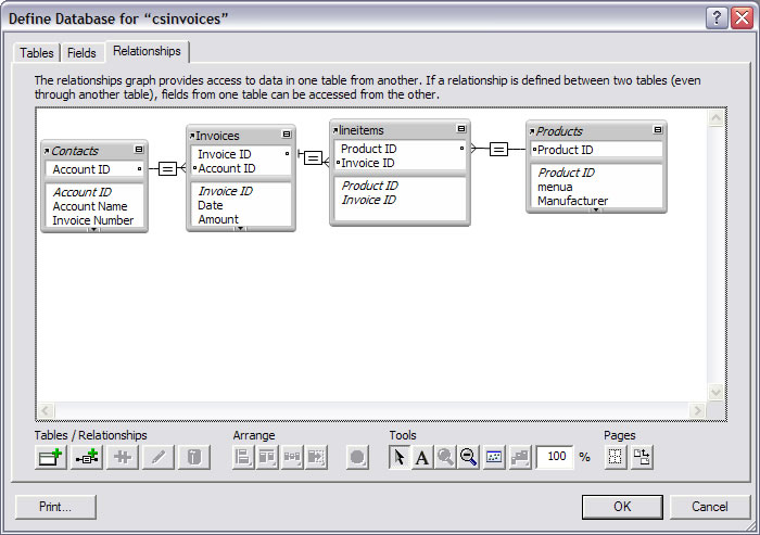

Ok, So I've now setup the relevant join table as suggested and ensured the field types are set so as the relationships work correctly.
But I am still unsure as to how I should best implement the lines into the invoice. Am I to use repeating field lookups or a portal?
It seems when I use a portal I cannot enter data into the Product ID field, and when using repeating field lookup and entering the product code (or using drop down table to select a code) the product name field isn't changing.
I'm sure I've done something wrong but can't work out what.
I've included a screen grab of my relationship graph
Okay, scratch that last request. I seem to have found a way to display them through a portal that requests the relevant data from the Line Items table based on the invoice number.
I hope this is the right way of doing it, if not - I'd be grateful for the advice.
