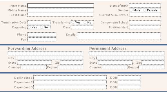

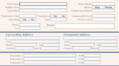

Please refer to attachment of what I've done. As you can see, all boxes are white, there's a barely noticable text blinker and a light line on the active field.

From Layout mode, select Layouts > Layout Setup and uncheck Show Field Frames when Record is Active. Not only does it look better because all the dotted lines will disappear but it will then NOT show the layout background and your 'highlight' will work. :wink2:
In addition, if you format your cursor to be inside the field by several px, then it will 1) look better because it provides 'gutter breathing room' around your data and 2) allows the cursor to be easily seen. Select the field, then Format > Line Spacing and Custom. You want to Indent left by minimum 5 px. If the indent shows in, then you will need to first View > Object Size. Then click directly on the in until it turns to px THEN go change your left indent to 5 px. I usually indent by 8 px. :wink2:
Whoa. "Change the background behind the field to a color other than white "
I confess I skimmed this part because it seemed ON but it is not. It is reversed. Your background (your LAYOUT body) should be WHITE (if you want your highlight to be white). Don't place a rectangle under each field - place a colored rectangle - that peach color - over your entire layout. Then place your fields on top of the peach rectangle. Make your fields transparent fill. Turn off 'Show Field Frames.'
