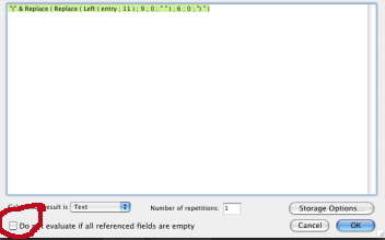

Lets establish one fact the resulting format are bound to be "text" to behave most predicatble!
My stab at it would be this:
"(" & Replace ( Replace ( Left ( entry ; 11 ) ; 9 ; 0 ; " " ) ; 6 ; 0 ; ") " )
...and please note that last paranthesis if followed by a inside the quotes!

Hello Folks
Further to my post yesterday to say that it works. I have encoutered a little problem.
When I open a new record Iget "()" automatically showing in the field.
Anybody know why this is happening?
Martin
Yeh add an if expression in there to check if the length is correct, otherwise it tries to format a non existant number.
Yes the checkbox in lower left corner have been deselected... It makes most sense to have it checked to deal with NULL values!
