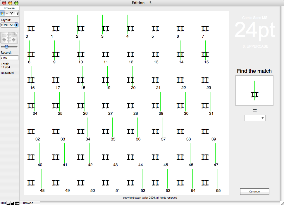

Ok... Only semi accurate way out of this I can see is slightly insane... but never said I wasn't.
Now I can see a reasonable way of editing a body of text with a nested custom function only thing left is to know exactly how long the lines of text are (in pixels) ...
Answer: Font database with pixel measurements of characters to relate to pixel widths of text boxes:
each record contains
1. a font face/name
result = limit to Arial, Courier, Helvetica, Lucida Sans, Times New Roman, Verdana
= 6 Combinations
2. a font size
limit to 6,9,10,11,12,14,18,24,48,72
result=10 combinations
3. font style (or combination)
limit to (plain - default) bold, italic, underline and uppercase
result = 15 combinations
6 x 10 x 15 = 900 font records
whats in the record?
There are 4 major font width differences
i 1 | l ' , . : ; ! I ...are thin
t f j ) ( { } ] [ " * ...are medium
q e r y u o p a s d f g h k z x c v b n ? / < >£ $ ^ & _ - + = 2 3 4 5 6 7 8 9 0 ...are standard
w m @ % QWERTYUOPASDFGHKLZXCVBNM ...are wide
so we measure
thin_character
medium_character
standard_character
wide_character
900 x 4 =3600 field entries for 6 standard fonts
this sorts out the required mearurements to reasonably confidently calc the indent
hmm is it worth it?:
(ps built the database for visually measuring fonts which works very well & created records with loop script for all fonts on my mac ... 11904 records (maybe not... x 4 is a lot of field entry time for an indent)
OK so now i have an answer (and if i data entry 3600 records the solution) anyone got a shotcut or completely different solution...
still looking for ideas...
attached is a pic of the font setup layout...
of course the font characters may differ cross platform but not sure...
suppose could also differ from display dims to print dims too?
