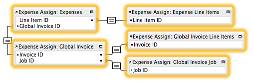

As my current project grows it has become increasingly hard to make sense of the spaghetti maze in my table occurrence window. In an effort to help get a handle on things I purchased a FM8 book called "The Missing Manual". In the book they illustrate using table occurrence names that look like this:
Expense Assign: Expenses
Expense Assign: Global Invoice
Expense Assign: Global Invoice Line Items
So I started naming my table occurrences using this method but the colons seemed to mess up certain calculation functions.
It was late, I was on deadline, so I just started removing the colons and it corrected the problem. Now I am going back in to see if I can come up with a new naming convention to help get this project under control. I can't remember which calculation was giving me the problem so I am unable to reproduce it at the moment.

See for yourself, they have the file referenced in their book posted online here: http://examples.oreilly.com/fmakerprotmm/MagnumCh8.zip
I have also attached a screen shot.
... why not just use an _ in its place?
Halburn, I believe you!!! As I said, you've saved me some money.
In view of the problems you had with the colons, it makes you wonder how well the author of "The Missing Manual" tested the examples.
