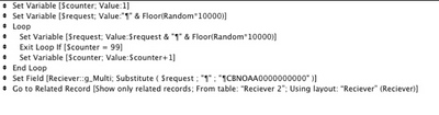

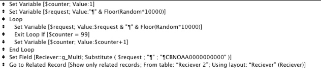

I might be misreading the thread, but why not use a filtered Portal? 100 find requests does sound excessive, and if you are looping them it would suggest that a many to many relationship might be more appropriate. I realize this does not really answer your question, but I think it would be much faster, and not difficult to set up.
For your last example, you would just set a global field to your 100 variations of your query term, separated by carriage returns. Create a relationship Global=Blah, and view all the matching records in a portal very quickly.
-Raz
added example
Your approach isn't utilizing the power of relations, and by putting on "==" are you making the indexing a step further than actually required for this purpose, you would never search on partial strings. By storing long similar strings or you enforcing redundancy on your data, which actually only is an attribute to the data ...perhaps required by the plugin, but nothing to make a habit out of!
Alright I can make the same in half the time via the above script, and it's actually both to generate 6000 records and single out a the sample of records the 100 random number suggest (please consider the lack of uniqueness in random numbers) ...but all in all isn't it the making of a found set that takes time here!!!!
While thinking at it, is what takes time by building request on request the validation of the input as well as commiting each request ...it happens each time your script makes a "New...."
I gave you idea a stab! The attachment to this post is something that easily can be changed to recieve the output from the plugin....
I even tried to measure if I could get a time for the scritpt to evolve, but it singles out the required records in less than a second. This means that the generation of 6000 records is the only thing taking some time to make approximately 10 seconds on my old dozy G4 powerbook.
speedtest.zip
