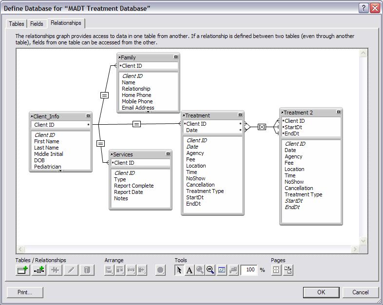

I thought maybe what I'm trying to do would make more sense, if I posted a screenshot of the table relationships and the database itself. I'm having a few problems implementing the approaches that you guys have suggested.
First, all the approaches I've seen thus far rely on portals. I am trying to make a printable invoice, where each record is on a separate line (I think FMP calls this a "List View"). I don't really understand how I can use a portal in this style of layout. I need something that will print and look like an invoice, with a header, body (repeating "body" section for each record), footer, etc.
The other thing is, I'm not sure which table should have the "StartDt" and "EndDt" fields. I've made them global variables, but in LaRetta's example, she had them in the equivalent of my DB's "Client" table. I don't think this will work in my situation, because I need to have an occurance of the Treatment table that shows all records, and doesn't select by date, for data entry.
Basically, I need to have a 'Treatment Data Entry' layout, where the user can see all the entries in the Treatment table, and then an Invoice view, where the user can enter a start and end date, and see (on the layout) only those entries in the Treatment table which lie between the two values.
In order to try and do this, I created a second instance of the Treatment table in the Relationships graph ("Treatment 2") and then joined it to the first instance of Treatment (that's where I did the greater than / less than relationship).
This is tough to explain but I think if you look at the relationships graph or at the DB itself, it'll make sense.
Unfortunately, this doesn't seem to work.
Any suggestions?
Treatment_Database.zip
Well, you could find those records through a traditional Find, but using the relationship is more versatile. In this case, by putting the global date range fields in the Client table, you can show a portal of all Treatments, and a portal by that date range. The Invoice can them be generated from there. I've modified your file to show this.
You may want to add a Status field or Billing date to the Treatments table and the relationships so a Client doesn't get double billed.
Treatment_Database.fp7.zip
