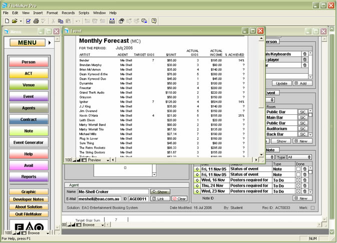

The weird thing is for the first 4 acts this is what is showing;
Act 1
Target - 7, Actual - 3, % achieved - 14%
Act 2
Act 3
Target - 4, Actual - 5, % achieved - 25%
I am using exactly the same field calculations as you are but for some reason it is going crazy.

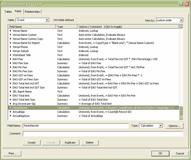

Round(Count( @ Record ID ) / Act::Target Gigs;2)
So that isn't my problem, any other ideas? Sorry I can't put the files up here but they are just way to large :)
Ok, record id is text, does this matter if I am only taking a count of it?
It's not the records ID you should use in your calc, but the related tables records. The syntax should have some :): in the middle between tablename and fieldname!
So the Record ID from the ACT table?
Round ( Count (Act::)@ Record ID ) / Act::Target Gigs ; 2 )
No... Count(Event::@ RecordID)/Act::Target Gigs
BTW how does @ work in your environmnet, I would never ever use it in the syntax neither would I use spaces in the identifiers??
Yes me either but unfortunetly i am working with DB's that someelse created and they are ingrained throughout the 12 DB system :)
I have tried this but I am still getting the calculations, which leads me to think that something is being stored or there is a typecast but I can't for the life of me work out where :

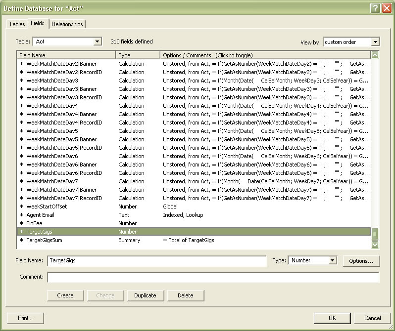

I have attached a screen shot of what is being returned and the field set up of the fields being used.
Act DB - holds target gigs
Okay I have worked out how it is getting 14 and 25!
Once it does the calculation it is dividing by actual gigs again
ie
3/7 = 42% divided by 3 again is 14
5/4 = 125% divided by 5 again is 25
Does this maybe have something to do with by sub summary part?
Any ideas?:)??
