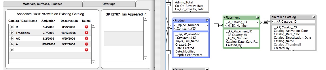

I want to track which products are featured in some catalogs.
On my Product table I have 2 portals. The first just creates the entries in the green Placement join table. I'm able to see fields from the distant Retailer_Catalog table just fine.
In the second portal I would like to show only catalogs the product has appeared in in the past.

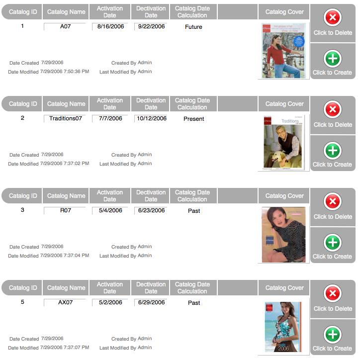

I created a calculation for each entry in the Retailer_Catalog table to determine if it's in the past, present, or future and it looks like this:
Let (
Today = Get ( CurrentDate );
If(
Today > Catalog_Deactivation_Date; "Past";
If(
Today ≥ Catalog_Activation_Date and Today ≤ Catalog_Deactivation_Date; "Present";
If(
Today < Catalog_Activation_Date; "Future"; "ERROR"
And the calculation works...yay for me. But now I'm confused as to how to establish the relationship between that portal and that calculation.
I know I need to make some TO's to establish some other relationship...but TO's of which table(s)?

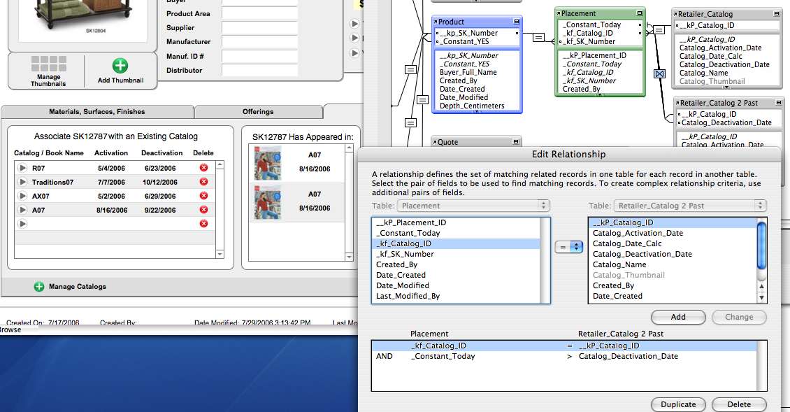

It's actually quite simple: add an unstored calculation field cToday to the Placement table (result is Date) =
Get (CurrentDate)

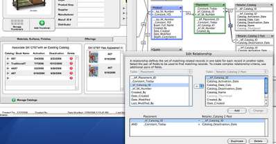

Place a new TO of the Retailer_Catalog on the graph, and connect it to the Placement table like this:
Placement::)_kf_Catalog_ID = Retailer_Catalog 2::_kf_Catalog_ID
AND
Placement::cToday > Retailer_Catalog 2::Catalog_Deactivation_Date
A portal on the Product layout, showing records from Retailer_Catalog 2, will show all past catalogs the product has been placed in.

Thank you for the fast reply. I believe I did what you suggested but for some reason, it just shows the first record in Retailer_Catalog twice. And that catalog is a future catalog,
Hehehe...Did I break FMP?
*** DOH! I forgot to change the table the portal points at to be Retailer_Catalog 2 Past....now it works...THANKS!!!!
