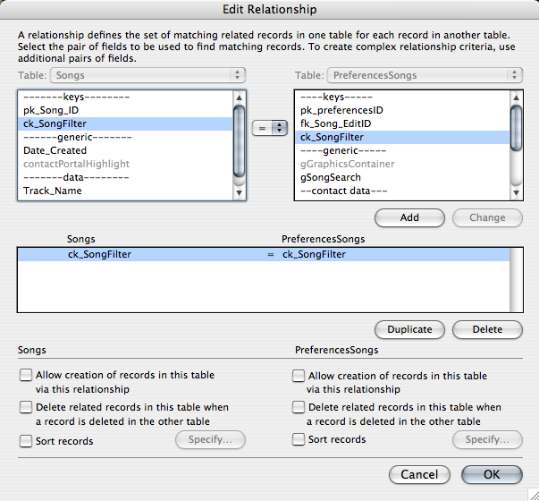

Hey Jon,
You were SO close! All you need to do now is change the relationship between Songs and PreferencesSongs. See attached.
