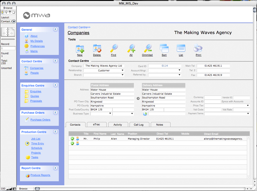

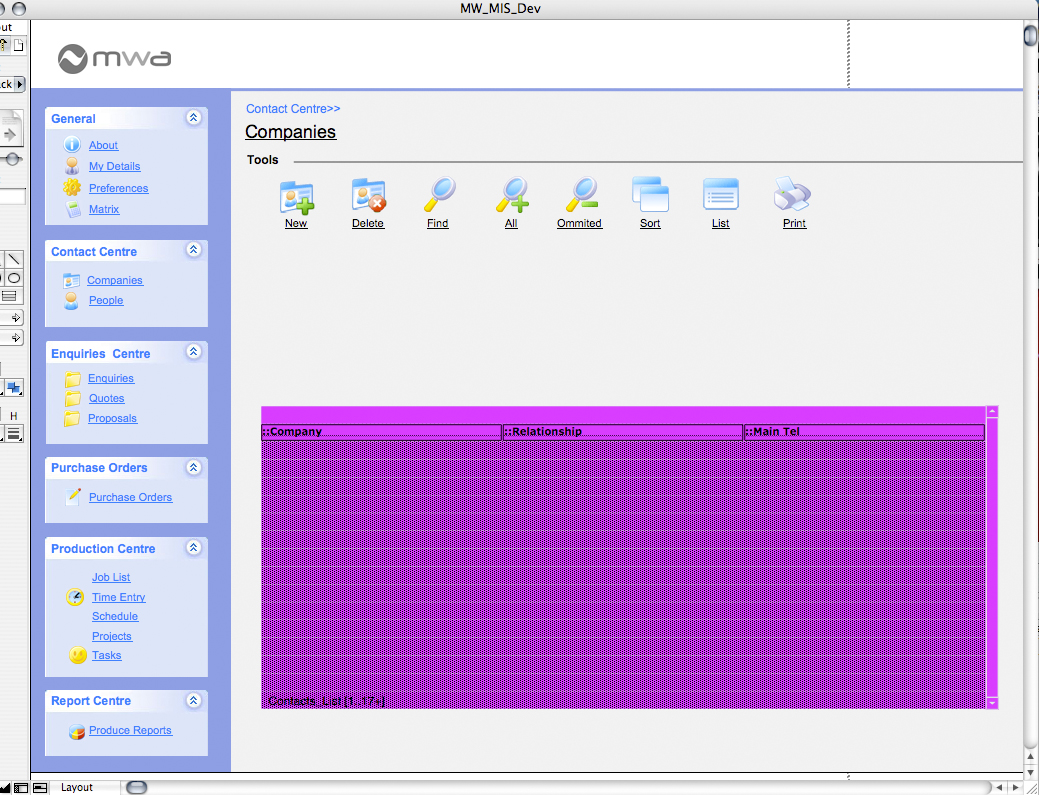

I probably haven’t explained accurately so here’s the whole deal:
Layout ‘Contacts’ (see attached pic) contains three specific Browse fields that need to show as list column headings in another Layout called Test_Background (see attached pic). The 3 x fields are Company, Relationship, Business Type 1. Layout Test_Background has a Portal with the 3 x fields. In my database are 2 x tables, Contacts (containing 230 records) and Contacts_List (containing 0 records). Contacts relates to Contacts_List through the common field ‘Company’. The Portal is set to show records from Contacts_List but this has no records. The 3 x fields are set to the Contacts_List Table.
So, how do I get the field data from the Contacts Layout on to the Test_Background layout to show up as list rather than a set of individual records. I have tried changing the relationship between the Contacts and Contacts_List tables from “=” to “x” but no joy.
Is the upper left corner of the field completely inside the portal?
Yes it is. Interestingly I managed to get the first row to show a company name yesterday, then deleted the whole lot and started again. Now I cannot get anything to show in the first row of the Portal.

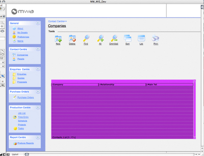

Your portal fields appear to be on the second row. They should reside entirely within the first row (the white row).
Moved the fields but still no records showing in the portal
Again, move it away from the left edge of the portal. That is a danger zone. It's too far left. Just to be sure, make your fields smaller and move them away from the top edge (but stay in the first row) and move them away from the left edge.
