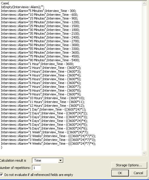

I have a portal that tells me when a task is scheduled - ::Date of task/::Time of Task/::Alarm/::Reminder Time.
::ReminderTime is a calc field see JPEG above:

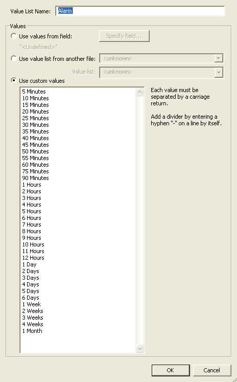

The calc gets data from the Alarm field see JPEG above:
Which is a value list.

As long as I am choosing 5 minutes to 12 hours everything works fine. If I want to set the reminder to 1 + days/weeks before it does not calculate. I have figured out that I need a calc that will set the ReminderTime to a day before at the same time, but, I can not figure out how to set up the calculation.
Help Please!!
Thanks,
Al
If anyone has any suggestions as to how to make this shorter and more efficient pleae tell me. :D
It looks like you need to add a date element to the Reminder, e.g. make the calculation result in Timestamp. Then you could use something like:
Let ( [
f = Case (
PatternCount ( Alarm ; "Minute" ) ; 60 ;
PatternCount ( Alarm ; "Hour" ) ; 3600 ;
PatternCount ( Alarm ; "Day" ) ; 86400 ;
PatternCount ( Alarm ; "Week" ) ; 604800 )
Timestamp ( Interview_Date ; Interview_Time ) - GetAsNumber ( Alarm ) * f
