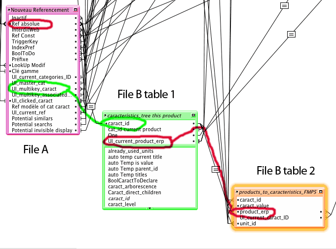

See the following image.
I've File A which contains products commercial text
I've File B that contains the product carscteristics
Table 1 of File B contains the different possible caracteristics
Table 2 of File B contains the values of the caracteristics.
Table 3 of file B, not depicted, contains the potential caracteristics a product of a particular categorie could have

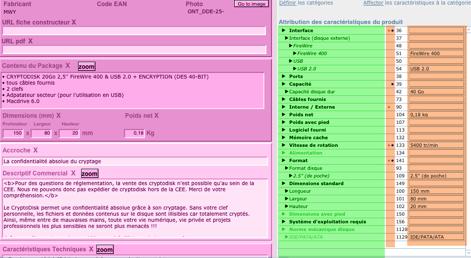

On my layout, to display the potential caracteristics this produt could have, I first I create a multikey containing all the caracteristics of the categorie of this product.
Using that multikey, I display all the caracteristics in the green portal.
in that portal I can put the values (orange area) of the caracteristic of the product from table A.
Green table 1 of File B doesn't relate to the product A, but it's portal has to allow me to set the caracteristics of the product in the orange table 2 o of file B.
So, I need to pass the product sku to the green table, and I do it with a script that sets the global UI_current_product_erp in the green table.
I don't want to rely on a script to set that variable, I want that the simple fact of being on the layout of table B showing a particular product would update the global UI_current_product_erp in the green table.
If I could put the sku of the product currently displayed on my layout in a golbal of file A, then, with a 1=1 relationshipt I could set a calculation in the green table that would have the sku value.

I've only depicted the file to point it wasn't a self join, I don't need assistance on the file as it is very complex and works ok (the only drawback is to trigger the passing of the sku in another file with a script).

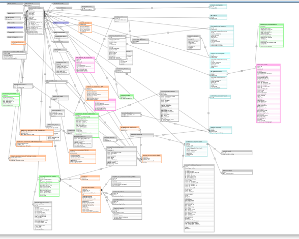

For you all to get a good laugh, here's the relationship graph of just the pink file. So you'll understand that although I should, I can't change much.
