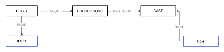

I believe you can still achieve what you want by modifying your structure a bit, for example like this (attached).

1. Make another TO on your graph of "top5roles" and connect it to performers, role to valuelist; I'll call the TO "perform roles"
2. Make a field in performers I'll call "role sort": a calculation that is simply:
perform roles::id
3. Sort the portal on this new field.
You'll notice a problem: the records in the portal with no role sort id will be at the top. But we want them at the bottom. The simple solution is:
4. Make a value list
0
1
2
3
etc
... and sort the role sort field with a custom order based on this list.
Many thanks to you and to Comment for your feedback.
I've now changed the database structure and implimented the steps that you describe with the exception of step 4.
There are over 1200 roles across all the Shakespeare plays so I thought that a custom value list of this size might slow things down. Instead I changed the "role sort" calculation to give any performer records that are not linked to a role an arbitrary high value above 1500.
