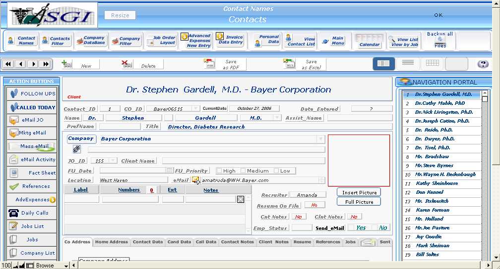

Here's what it looks like in my app.
SO I'm not sure what you mean by:
I'm pretty sure that's not a Viewer Table
I view each contact individually, edit, view and add data as needed and when I click on the name in the portal it takes me to the next record. If I didn't want the user to do anything but read the data I can turn that off in layout mode. But, you know what you need. BTW, this app uses a gtrr as well. It also uses a CF to set things up.
