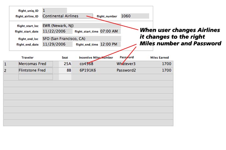

I was looking through your file for the last few hours and I try to replicate it. I ran into a error. I do wonder if there is a way that in "flight_info" that when you choose a different airline the ff miles, password and miles automatically update to the specific airline chosen.
Thomas

Maybe I did not explain to well. Now if I choose the airline the passengers have a different miles number. See image.

I think that each flight should have its own set of passengers and basically in layman's terms make a "copy" of what is in the ff table for that particular customer at that time.
I do not think that this should be a reference but rather a stored value.
Again, my question to you is: Why would you change an airline??? The flight number for a particular airline should be set PRIOR to any passengers being placed on board. After you select the airline, and put passengers on there, you shouldnt be changing the company name.
