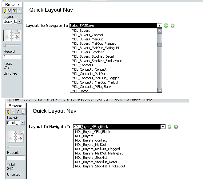

I've come to highly dislike scrolling through filemaker's pop-up layout navigation for 20 seconds to get to a layout in my gradually larger solutions.
To overcome this problem, i simply built a simple layout nav system for myself -- a table, and a drop down box -- see attached.
If you wanted to categorize your layouts as i do in my real solution, then it's just another field and a simple relationship filter (conditional value list).
Cheers guys, hope it's useful.
Alex

The main purpose is only to allow quick navigation in 2 circumstances 1) Your Layouts aren't organised that well but use a standard naming technique 2) You have a whole lot of layouts, and it takes you forever to get to them.
I have no problems with the filemaker layout navigation... for the first 20 or so layouts.. thats fine, 2 clicks, but using a pop up menu to have to go through all of them in a solution greater than this is absolutley ridiculous.
The only point of this file to be honest is to be a quick point of call, you need to get to a layout? Choose the first layout in your solution (quickly locatable, and easily accessed using FM's nav system). And then either superscroll through an alphabetically ordered list of all your layouts, or use FM's autocomplete function to narrow it down.
All i can say is that it makes my life a heck of a lot easier -- i just counted and it takes me full 30 seconds to scroll through all of my layouts on a full 1280 x 1024 resolution -- as opposed to choosing the first layout, and immediatley selecting any layout i need.
Again though, it's just a general technique, if it does very little, then that's probably as much as it will do.

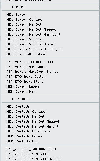

My 2 cents worth - my layouts are ordered alphabetically within group. The group names are all in the format "--- GROUPNAME ---". This is the only place I ever use all uppercase, so they stand out. The groups are organised, more or less, in order of importance. I do the same with Field names.
This is something I picked up ages ago from this forum.
Re General Layout Organising.. I using the following convention, and while it does work well, again the time factor is annoying as hell...
...MAIN SECT
MAINS_LAY_MyLayout_MainSection
MAINS_LAY_MyLayout_MainSection2
MAINS_LAY_MyLayout_MS_SubSection1
MAINS_LAY_MyLayout_MS_SubSection2
MAINS_LAY_MyLayout_MS2_SubSection1
MAINS_LAY_MyLayout2_MainSection
etc.
etc.
MAINS_REP_MyFirstReport_TO1
MAINS_REP_MySecondReport_TO2
MAINS_REP_MYSecondReport_TO3
MAINS_MER_MyOnlyMailMergeLayout
...MAIN SECTION HEADING 2
MAINS2_LAY
etc.
etc.
I usually truncate the names to some extent in order to make them shorter so they fit into the non expanding lists that FM uses (another thing i dislike) and then can quickly locate them at least in the scriptmaker dialog.

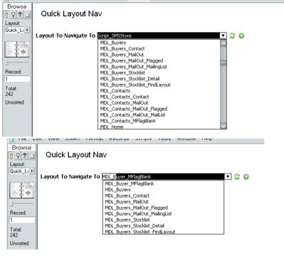

RE: The "complexity" issues, see the screen shot below, i may have overstated the complexity a bit..
