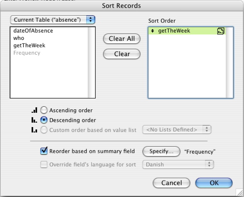

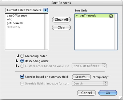

Of course there are hundreds of absence records, and they will be from various dates and weeks of the year.
This means that there is no excuse from a real subsummary report, where you along the path if you're using the wizzard to make it stumbles over a dialog asking for sorting ...here are we with fm8.5 blessed with the ability to use the reorder by summary field ...looking almost like the image above.
I have made the summary field "count of who" ...
Thanks for the reply. I see that you are using a sort to find a frequency, but how do you define the "range of days" as far as the week goes, and how is this reported in this scenario? What data is "Who" collecting? And what function does "get the week" perform? Sorry if I'm being a bit thick.
- Sea
You had also better include the year in that leading part. Otherwise week 41 from 2004 will group with week 41 from 2005 etc.
