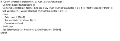

The thread has evolved considerably since I set out to make a template, but here's how I would accomplish it.

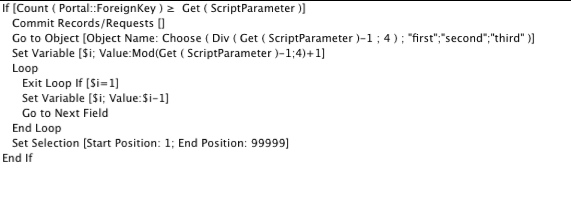

Indeed I can - the key to it all is the new Object features. What I have done is naming the field pulled into each of the visible portal, something different.
But lets take the script right from the start.
1) We need to be sure that the desired portalrow exceede what's availiable.
2) Removes the cursor from being parked in a field.
3) Here do I select the object to go to, the function Div( returns the next lowest integer value after dividing
4) The rest from the division gets us number to the correct row in the selected portal.
5) Which is used by the looping to end in the portalrow.
6) Since the Go To Next Field just jumps into the field without selecting the enire content do we at last select every char from 1 to 9999 in the field.
So what you need is to make a field in the new portal an object as well. Then do you need to adjust the Choose( found in third line of the script by adding the word you have chosen in quotes following the word "third" ....

OK, I've got the hang of it but have one more complexity which upsets line 3 of script. That is not all portals will have same number of records!
Div function does not work with some portals having more than 4 records.
Any ideas?
No the 4 is the number of rows in each, if your portal have 6 rows change the number accordingly. So sime sort of splits aree needed to change the base, and the overflow....
What I mean is some portals may have 5 records, some 6 some 10 etc. If they were all the same then your solution works fine - as you say by altering the div value.
I'll get you a solution tomorrow, a Case( statement should steer the the Choose( statement as well as the carry overs.

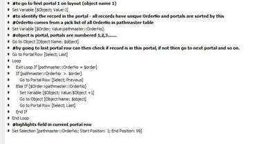

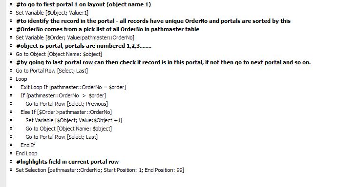

OK Soren, with your help i've cracked the problem. Your script works great when the portal row only conatins one field - in fact I think it can be simplified - see my adaptation in attachment.
For my portal, with multiple fields I have found a different solution - see pickerscript.jpg
I doubt if I would have got there without your ideas so many thanks.
Ian
