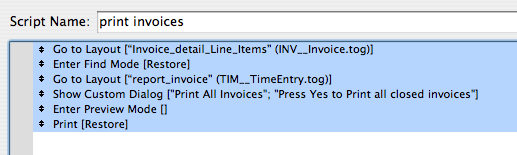

Hello forum so i have made a script and most of it works, but it only prints 1 invoice even though my find criteria shows 4 records, here are my steps.please see picture.
the aim of the script is to find all invoices that are closed, go to another layout that shows my finished invoice layout (report_invoices) and print them.

Double Click your print script step, up the very top where it has a drop down that at the moment will say something like "Print Current Record Only" change this to all records being browsed.
Thanks Genx but it still does not work, i still just get 1 invoice trying to print, i am using the job time tracker by soliant consulting (downloaded from filemaker.inc) and have now tried for hours but no success,
i tell the script to go to "jobs" find all jobs that i have marked as closed, i then run a script "generate invoice" this saves me from pressing a button on every single job to create an invoice. it should then go to the "report invoice" a page that has my logo and address. and to print these records but it does not want to generate these invoices. i think there is something in the "generate invoice" there is also another script that is "invoice_print_report" script that is stopping me getting any further. i have included the file with my script i am using if anyone can tell me where i am going wrong..still struggling with this one.

Open up your print invoice closed script, and just remove the Enter Find Mode[Pause] script step all together, you're using Go To Related Records, which eliminates the need for Find Mode in this case.
thanks i have done as your instructions but i only get 1 invoice to print i would like all the invoices to be ready for print i think there are 3 in the supplied file but it only shows me one to print.
what i would like is to find all the jobs that are closed generate an invoice for all these jobs then print all of these invoices. thanks for your time and wisdom.
