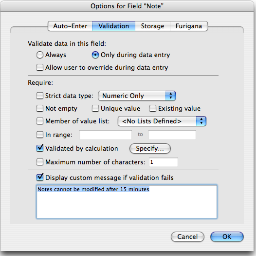

Do you know how to lock the old notes so no one can edit / delete them, once they have been entered?
You can validate the Notes field with a calculation. First, you must have an auto-entered Timestamp field, with the creation timestamp (you need this anyway to sort descending). A calculation could be:
Get ( CurrentTimeStamp ) - TS_Created < 900
That gives 'em 15 minutes to finish writing the note. People who start writing and leave their cursor in the field are going to get a nasty surprise.
If, for some reason you want to only have this limit for certain people, but not you, you can put the validation in the record-level restrictions in specific Privilege Sets, in Accounts & Privileges.
Here's what my validiation options look like; uncheck Allow user to override.
