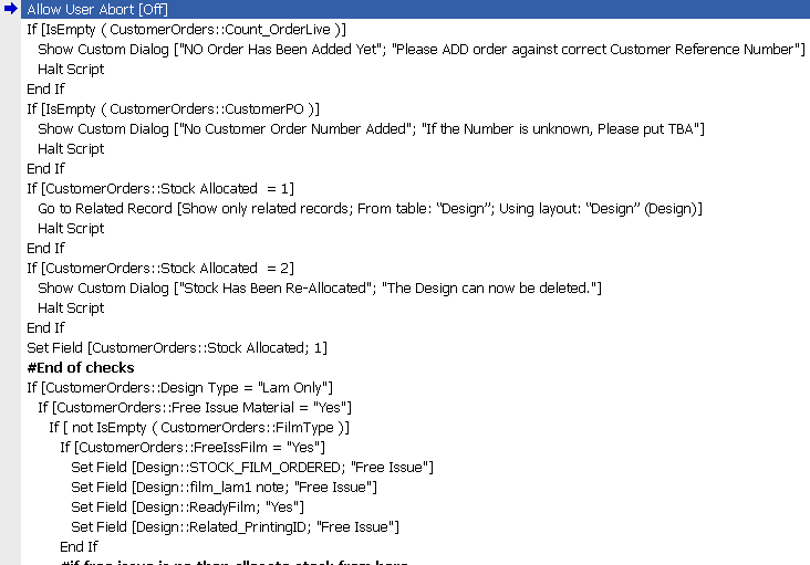

The script is long bit I have the first part of it attached.

I see a few issues: 1) You have no test that there are related records and 2) the multiple Ifs[] after End Of Checks is concerning, ie, I believe all of those tests can be combined in ONE If[] statement. I see nothing else in this portion of script you have presented.

with reference to 1... The related table is the same table so I know there is a related record.
With reference to 2.
The problem with the script is there are so many conditions of which I need to check for...
The multiple (if's) are necessary, there are if's within if's because they all fall under the first IF.
But basically you are saying that this may be causing the problem??
But, However, I still can abort the script as soon as the script goes to the first IF. Regardless.
Ben
"The multiple (if's) are necessary, there are if's within if's because they all fall under the first IF."
If any condition failed within one single If[], it would fail just as easily. Example: If this or this or this ...
And no, I'm not saying that's the problem here. I'm saying we need to see more of your script but the multiple Ifs[] aren't needed because there aren't different results required between each of them. :wink2:

Holy dog spit, Ben! I'm sorry but I've never had a script such as this. That doesn't mean it isn't necessary but multiple warning flags are flying for me!! I'll tell you one thing ... you truly MUST [color:red]put protections on those GTRRs. If any of them fail (no related records) then your script can run on the wrong layout/table - very dangerous not to include test here.
But, as you realize, you have more problems than that. Regardless, User Abort should NOT allow cancelling the script. What do I suggest? Step back, get clarity on paper and rewrite each piece as separate script. Test each script-piece thoroughly. I *believe* you have many Ifs which can be combined but I truly can't tell how (the file you presented, of course, trashed the *logic* when it trashed the tables and layouts).
Can you walk us through the logic? Pretend you are explain to new person hired, exactly what you are doing. If we can get to the underlying logic, we *might* be able to help. I KNOW your script could be handled more easily, for example (keeping in mind that I have no field or table names to work with):)

Thankyou for your effortse Here.Ummmm. i think perhaps I have got carried away... This script has grown and grown and yes, the structure lost a bit perhaps.
It is complicated though and its not easy to layout either... The conditions and combinations are cross referenced andninside out...
However, it works for what I need but thanks for the advise... I have some pretty complex relationships going on in this solution and they definetely need protecting...
