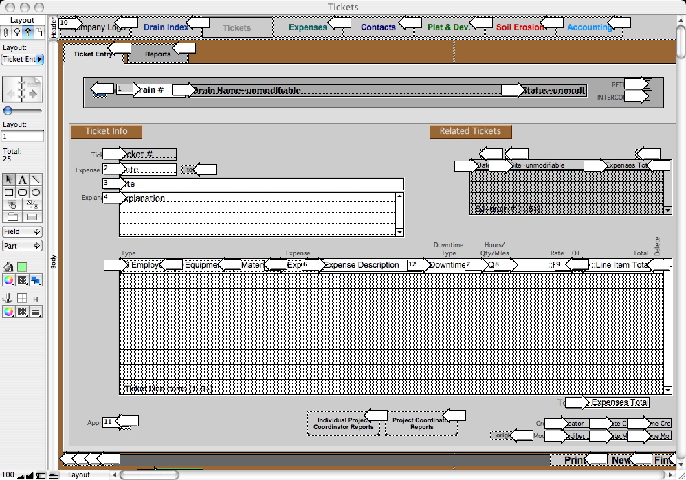

I've attached a screenshot of the original..the way it was working but now I can't seem to reproduce.
The backup copy skips 5 and then goes to 6
I don't think that's possible, so you should try and find that #5 hiding somewhere.
You need to enter the number in the fields that you want the Tab to move to.
I would just start by clearing all of the tabs (it's and option), and then work my way around the layout to the fields you want the user to tab to.
HTH
5 would be skipped if entry to the field was not allowed
I've been using 8.x too long. I forgot that v6 doesn't have the clear tabs option.
You can just relabel the tabs order and use the 5 in a different field.
I tried to clear and reorder and it still goes right back to number 1 after clicking an item from the drop down menu instead of going to #6.
