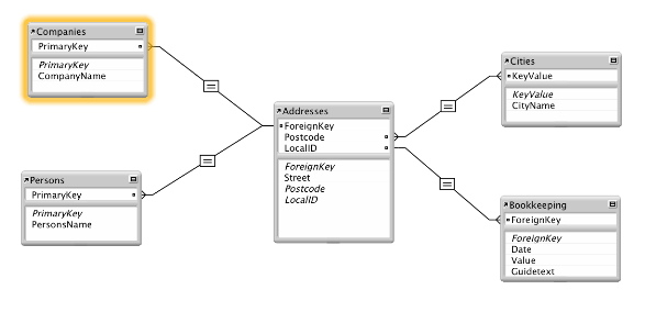

I think you should consider putting Persons and Companies in a single table.
Alternatively, you could define two separate relationships, one between Persons and Book Keeping, and another between Companies and Book Keeping (using two occurences of the Book Keeping table). But this could get quite complex: first, you would need to make sure no IDs are shared between a person and a company; and if you want to view related data from both directions you will need to switch to anchor-buoy model (more table occurences).
The Post Codes table also needs to be split into two occurences, along the same lines, instead of connecting between Persons and Companies.
Alright where my original model fails is when bookkeeping always are tied to a person, the alternative is as comment suggests and along the lines of this:
http://www.fmcollective.com/2006/12/postdesign_cauc.html
I'll rethink such a solution! Perhaps you could expand a little on this:
I have them separated in to tables, because I thought it would be a easy way to distinguish them from each other when handling the data
Both Michael and I feel it ought to be one table, but perhaps it's like the fmcollective that the two found sets are treated very different.

But you might if the attributes differs too much use the idea of the autoenter value is on foreignside the many-side, say like the attached image ...here is a plentora of addresses posible for both companies and persons, but each bookkeeping goes to one specific address.
