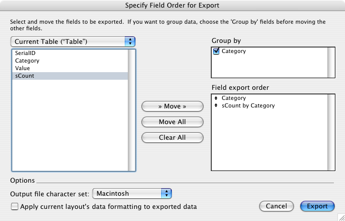

If you have a table with fields:
Category
Value
sSummaryField
and you sort the records by Category, you will get the option to group by Category when exporting (see screen shot).
More detailed instructions can be found in Help > Saving, importing, and exporting data > Exporting data from FileMaker Pro (para 9, Export grouped summary values instead of individual records).
