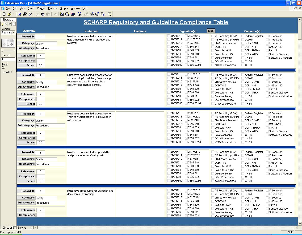

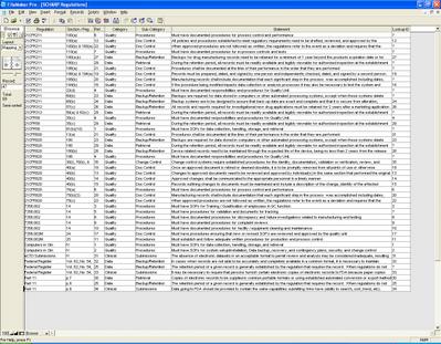

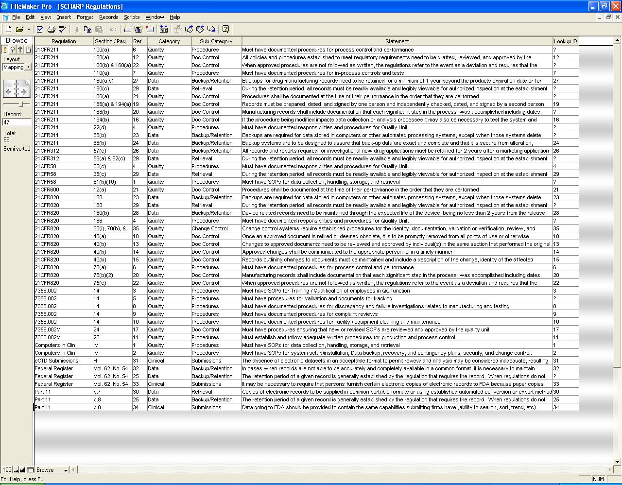

I'm not sure a good way to do example attachments but I did attach 2 screen shots from what I have now (the theme-regulation table and the mapping table).
You're right, I do have a many to many relationship. I was thinking per record where I have a 1 to many but that isn't the right way to think about it.
What I really want to accomplish is to have one table where I can see all the themes and for each theme be able to easily identify all the applicable regulations (that's why I like the checkboxes here as for one theme I can select multiple regs). But this cross-referencing doesn't provide enough info for someone to find the actual part of the regulation the theme is referencing as some of these regs are quite long, so I also want to have the regulation page number referenced so that's why I added the mapping table where all the info on the theme from the first table gets copied over and the custom dialog prompts for the regulation (even though it's the same as one of the checkboxes I haven't figured out how to do this automatically without it copying all the checkboxes - that's why I was hoping to have the script do a "for each" function) and the page number.

You're getting on the right track. Your Mapping script needs to create a record in another table for each separate regulation. Each record in that table will have the Theme ID and the Regulation ID. That table, called a Join table will relate to the Themes and Regulations tables. Then you can reference the Regulation table easily.
