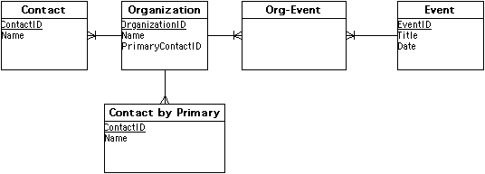

Does this model fit better with what you're doing? With this, the Contact-Event table is the join, and the mailing would be based out of there. If you wished to remember the mailings that are sent for each event, you'd add a couple more tables (Mailing and Contact-Event-Mailing) to track them.

How's this one look?
Although you don't really talk about it, I do think the join table is useful. It allows you to have the event information be stored in the Event table (Title, Date, Venue, etc.), and have information about the Organization's role/registration in the event be in the join. This way multiple organizations could participate in the same event (is this true??) and an organization can participate in multiple events.
The Primary Contact should still be kept as an ID in the Organization table. This is because there should only be one primary contact per organization (this can't be enforced if the primary contact is simply a flag in the Contact table). So a second TO of Contact is still used for the Primary Contact.
In this model, the mailings would be generated out of the Org-Event join (or a linked Org-Event-Mailing TO, if you're keeping track of Mailings sent), showing the related primary contact from the 'Contact by Primary' TO.
With the Primary Contact set up this way, you can then run your query in the Org-Event TO. There will only ever be one primary contact per Organization (that's essentially a one-to-one), so you wouldn't get the false positive you'd get from searching Contact fields from Org-Event.
This means you could run a Find in Org-Event for something like:
Contact by Primary::Position: "Big Wig"
AND Event::Event Date: ">7/1/2007"
and get Org_Event records whose primary contact is a Big Wig and are assigned to participate in any Events after 7/1/2007.
Does this work?
