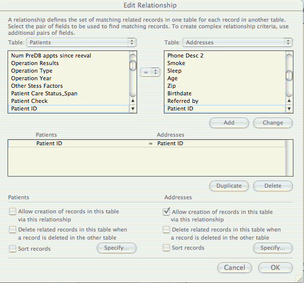

Are you basically saying that perhaps one of my relationships is set up in a way that if I am not careful to make sure that my
"Delete related records in this table when a record is deleted in the other table"
check boxes are not unchecked then I could be deleting something down the relationship line?
I rarely allow this sort of record deletion in my solutions. In this particular case it is a simple single relationship between a parent and child. No complicated relationship lines.
I've attached the schema. The parent is Patients.fp7 and the children are held in Addresses.fp7 a seperate file. It is the children that have disappeared totally.
Thanks!
Yes thats what I'm saying! Couldn't it sound like such a thing??

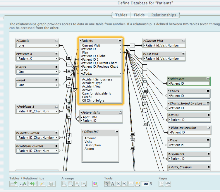

This must be because, the solution meant for general a practician, to have just one record for an entire household or how many of the patiens have several residences, and does it really matter in doctor patients base??
One thing that occured to me now, could have been a backup which reinstate a missing file, I could perhaps understand some use of the separation model, but splitting the addresses out in one single file is beyond me??
I have yet another thing, what about typemismatch in the keyfields, if you have a cascaded deletion set on will some weird results once and a while occure. Do you pre- or postfix your relaional keys??
BTW get rid of the constants, use cartesian relations instead, and to clear up the graph by deleting the keyfields after making the connection.
