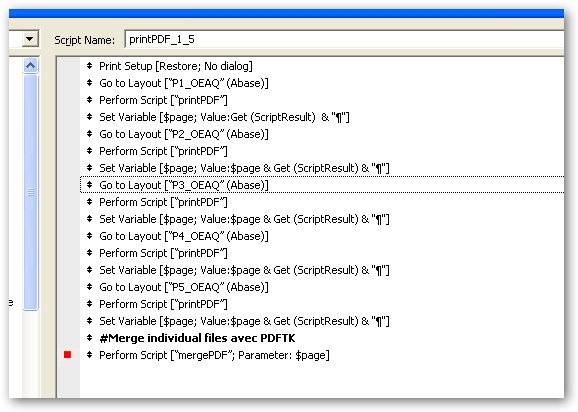

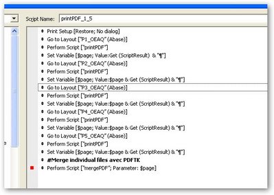

Here is a print screen of my script
I'm trying to print multiple layout in a single PDF file using PDFTK.
What I need is to merge all the filenames from results of different scripts. This way I can create the required parameters for PDFTK.
Actually, I used the workaround, but I would have prefered to used a more standard way to develop.
I see in your script that a single variable holds multiple values. I think that's how I would it, too.
