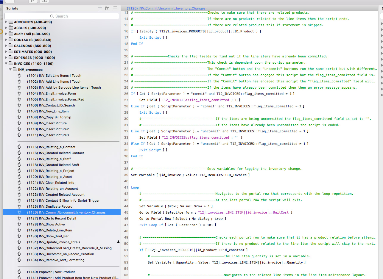

April 2, 201511 yr Newbies @Richard - Looks like there may be an issue with the script " (1116) INV_Commit/Uncommit_Inventory_Changes" in the current release. The loop exits right at the beginning since the portal is not found. Adding a script step "Got to Object [Object Name: "Invoice Portal"] " in the beginning of the loop allows the "Go to Portal" script step proceed since it is found (no 101 error) and execute the loop steps. Environment: FM Pro Advanced 13.05 Mac / FMS 13.05 Mac FMSP: 4.3v1
April 2, 201511 yr Author Yah... Good catch something is broke here. The fix it a not obvious....err not easy. So I need to look at it a bit. - RC The funny thing is that I shot videos on this in the last 90 days...so I don't know how and why this got broke. - RC
April 2, 201511 yr Author Ok... So You need to add one line of code... at Script 1116, Line 45. We are patching 4.3 tonight...so this is fixed. - Richard
February 23, 201610 yr Stock1.movHello Richard - First of all, thank you for sharing your skills and knowledge with us. You are a very big help in getting small business owners like myself started using Filemaker. Secondly, I've downloaded the latest version (I think) of the Starting Point Solution (FM_Starting_Point_46) (4.6.4) I am still having the same problems as stated above with the "Amount in Stock" not updating. I've 'Committed to inventory' after creating an invoice. I've also 'updated' the 'units sold' - But still , no change in the "Amount in Stock" field on the Products page... - - Well the amount never goes DOWN... Funny thing is, if I go back to the invoice and hit the "Revert to Inventory" button, the stock does go UP! (It's a start, I guess) (I've attached a little movie of the process in this post below) I also opened one of your older Starting Point Solutions (45), and everything works perfectly. Stuck ???? Thank you so much in advance... BTW - I'm assuming that this is not important but the line of code seems to be 1126, not 1116 like stated in your above post. Stock1.mov Edited February 23, 201610 yr by Randy Bennett

February 26, 201610 yr Author This has been patched and can be downloaded now. There was a missing scrip parameter... now it is 4.6.5b - RC
