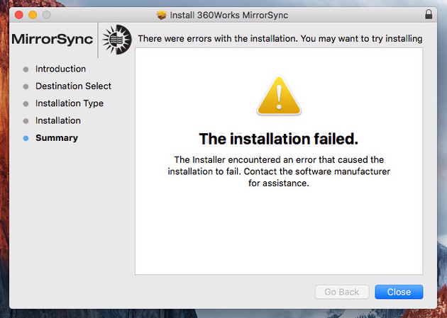

Jesse... tried to install on a Mac Mini (only running FM Server 14). Got a message that Install Failed, Contact the software manufacturer. (screenshot attached). Is MS2 compatible with El Capitan and FM Server 14? What am I missing?
Energuy,
MS2 is compatible with El Capitan & FileMaker Server 14. Sounds like Java may not be installed. Can you try installing Java? If that still doesn't work, can you give our office a call so we can do a screenshare to help you get this resolved? @ +1 (866) 662-9185
Glad we got this resolved! The issue faced was missing installer data. I will update our documentation to clarify that aspect of installation.
