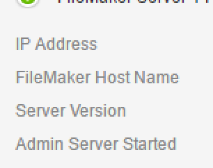

Make sure the Host Name set in the admin panel is the same as the fully qualified domain used for the SSL
That fixed the issue in my case
