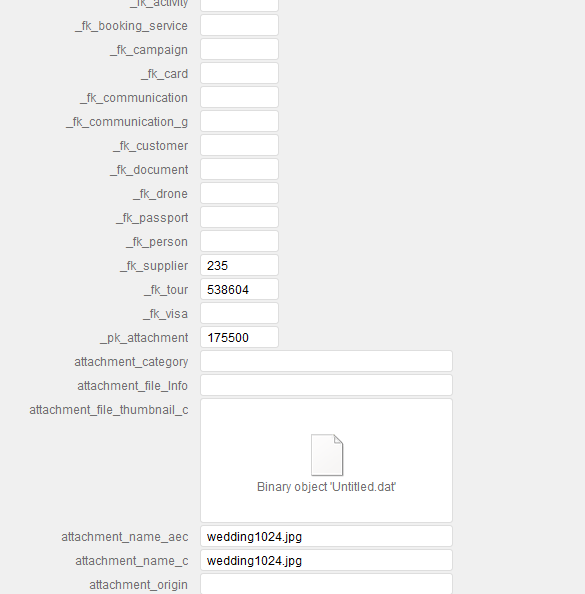

Hi Jesse
Changed the privileges, ran a vanilla initial sync and there were no errors reported this time
However, the data appeared in the container fields in filemaker as blob data and does not seem to have been converted back into FM container data
See screenshot
Cheers
Harry
Harry, I responded directly to your ticket in our support system, but for anyone else reading this topic, the Binary object 'Untitled.dat' is a bug in this version of MirrorSync that we've fixed in our latest codebase. If you're running into this issue, message me and I'll send you an updated version.
